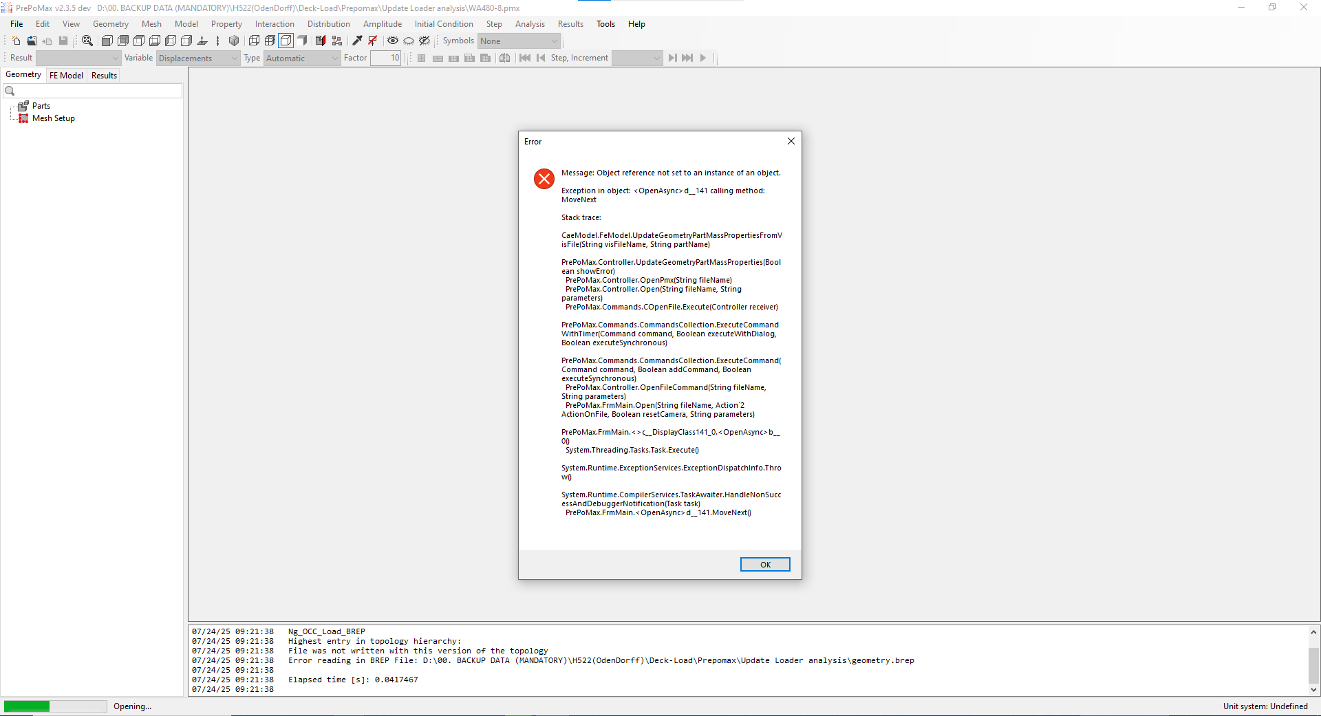

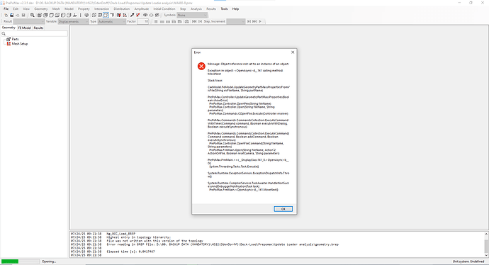

I was failed to open my pmx file eventhough i can save it last time with successfull result.
after that i switch to open the frd file (WA480-8) & it successfully open, i can now see my previous analysis. Now, from this open frd file i tried to update the analysis by changed to different loading. I noticed that while i create new analysis (analysis-1) i can now see my model & the pmx file was opened but the result of new analysis is zero.

  1. Why i can’t open my pmx file eventhough there’s no error messages when i was save the file?
  2. Why there’re no result shown for analysis-1 (the new analysis) ?
I can confirm the issue. I get the same error message when trying to open this .pmx file. And the Analysis-1.frd file indeed doesn’t contain any results (as can be seen by opening it in a text editor or GraphiX). Was it completed successfully after you submitted it ?

It is a bug with .stl files. It is fixed in version v2.3.7 dev. Please confim it.
Yes, i can open it now thanks Sir
