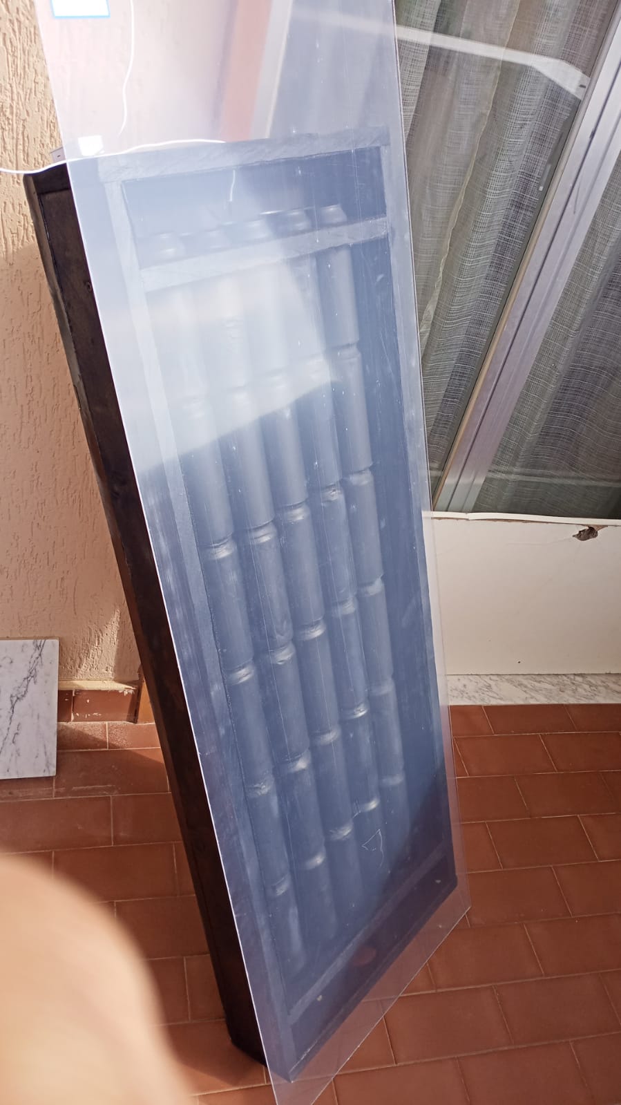

Can I simulate a Solar Collector, shown in the photo?
Can PrePoMax do this?
The cold air passes from bottom to top, on the top the air is hot.
The pipes are in ALluminium.
Thank you very much.
Giovanni
I have built this device using Coca Cola cans.
I don’t need a detailed simulation, but a very general simulation.
Also, i can simulate the Sun with a normal point of energy, without Radiation.
Thank you
Giovanni
Without coupling with CFD (which you could perform using OpenFOAM) it’s only possible to model the air like a solid and account for conduction in it. Or you can use convection load but it’s also only a rough approximation. Normally it should be simulated with airflow included - using CFD with heat transfer.
