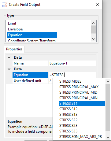

Hi. How do I add the components of the stress tensor to create a stress invariant? Thanks for your answer.
You can do it this way in the newest 2.4.0 version of PrePoMax:
This is in Results → Field Output → Create.

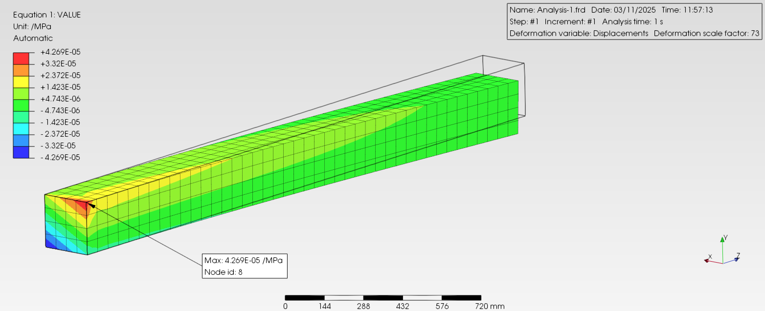

In version 2.4. works. This is the first main stress invariant.
