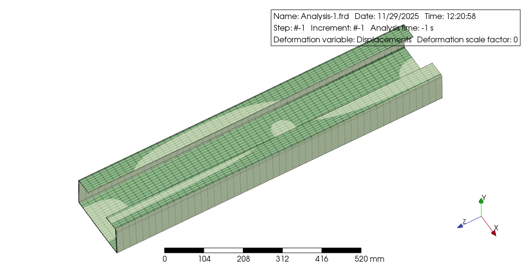

hi,

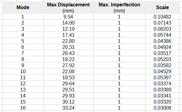

Generates final shape of imperfection is a tedious work and it could be useful when PrePoMax can do automatically. Below an example of imperfection models taken from eigenfrequency analysis, each mode needs to be saved and rerunning for total of sixth teen cases to generate final shape of imperfection. User defined by maximum imperfection (units of length) for each mode is more clearly than scale factors, usually a portion to width or height of sections e.g 1/200. Zero value can be meaning of previous deformed geometry being used to skip without analysis to run.

no any nonlinear analysis being performed, only eigen analysis and final shape of imperfection from deformed mesh combination in multiple case ran. The task can be explained as below,
  1. Performing eigenfrequency or eigenbuckling analysis
  2. User menus to defining maximum imperfection in length units for each mode
  3. Saved deformed mesh from 1st mode with scale internally
  4. Repeat the same case with updated mesh from previous and so on.

my proposed approach is different things by multiple case to run and updating to generate final shapes. Geometric imperfection is mandatory for nonlinear buckling analysis (large deformation and plasticity), accuracy of member capacity much depends on this user definitions. There are knock down factor for safety and tolerances also, since imperfection is unknow at design phase.

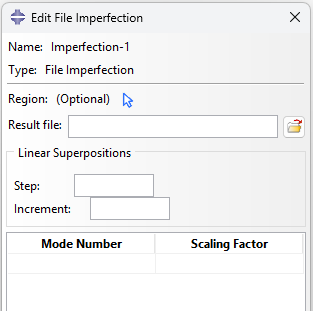

To clarify how it’s done in Abaqus - this solver has the *IMPERFECTION keyword, so it could be a request for CalculiX itself too. With this keyword, you can specify the imperfections in 3 ways:
  1. Based on eigenmodes - superposition of weighted mode shapes, you specify the file containing the results from eigenfrequency extraction or eigenvalue buckling analysis, then enter mode numbers and their corresponding scaling factors in the data lines. Optionally, you can choose the target nset.
  2. Based on a static analysis - you specify the file containing the results from a static analysis and select the increment from which the results are taken. The scaling factor is also provided. Optionally, you can choose the target nset.
  3. Defined directly - you specify the imperfection directly as a table of node numbers and imperfection components in the global or local coordinate system.

GUI tool for the first method introduced in Abaqus 2024:
