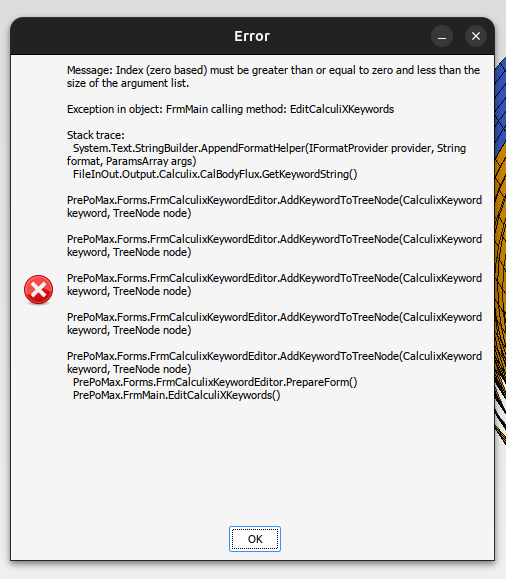

Steps:
Added CalculiX Keyword
Ran Analysis (failed, no result)
Model → Edit CalculiX Keywords
Model:
Composite_Shell.pmx (1.3 MB)
Steps:
Model:
Thank you for the report and file. I found the problem. It’s in the body flux keyword. If you disable it, you will be able to edit the keywords. I will prepare the fix shortly. In the current state, simulations using the body flux will not work.
Please confirm the bug is solved in version v2.3.7 dev.
Can confirm that the problem is gone on my side.
