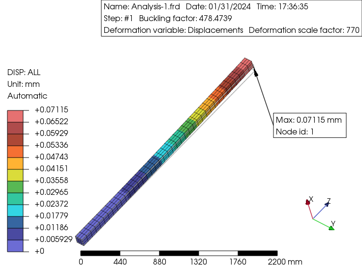

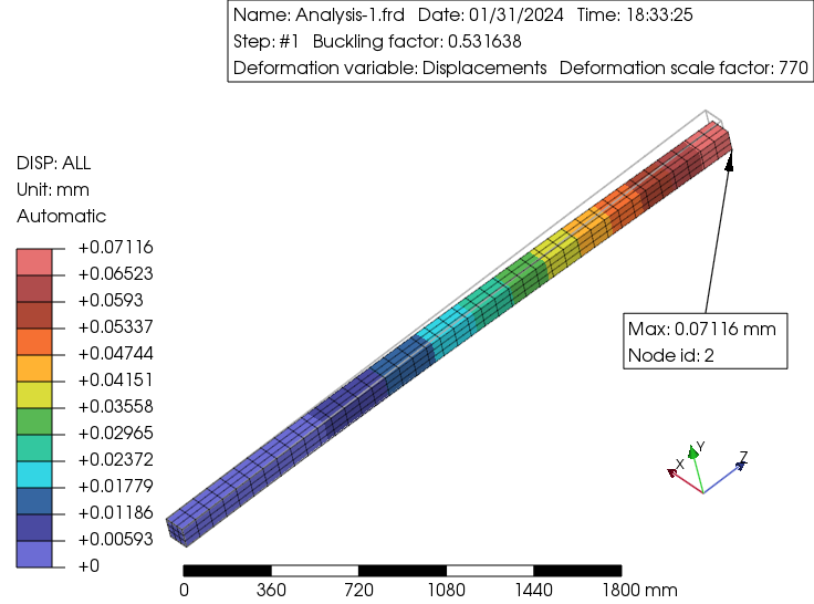

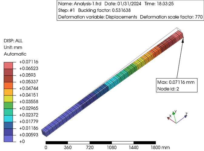

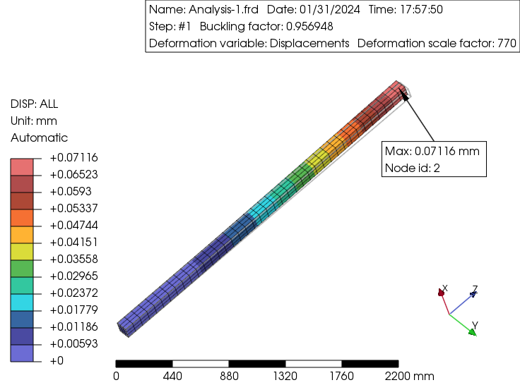

i do simple recreate the model, and it seems all the solver (Spooles, PaStiX, Pardiso) given consistent and identical results.
p.s unit load is -1000N and quadratic hexahedral element (C3D20R) being used.
i heard about the problem of Spooles MT in frequency and buckling analysis, in this case a distribution from CFTurbo FEA probably can solve the problems.
Yes, it can give good results like when the load is 1 N or 470437.10 N (the OP’s case). The problems start when the load is larger than the buckling load and the issues might be mesh-dependent as well.
if i can remember correctly, this problem has been fixed by Victor from Mecway (many thanks). Simple re-testing with load of -500000N for the problem cases above, still provide consistent result for all solver here.
I reported the issue here: First buckling mode skipped when applied load is much bigger than buckling load · Issue #74 · Dhondtguido/CalculiX · GitHub
Apparently because it’s still close to buckling load. 980665 N causes problems.
i can confirm. It seems load magnitudes still can be greater than buckling loads until two times, out of these ranges the lowest factor did not report well and it jumps to next probable buckling shapes.

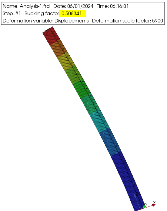

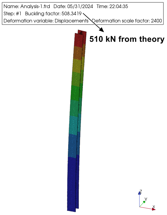

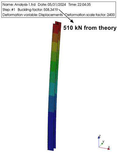

I’m studying a reinforcements for a column against buckling. For this aim I started a buckling analysis of a simple HEB200 column using RBE on the base and on the head of the column. I found a strange behaviour of the default CCX solver on Prepomax: With a compression load of 1 kN the results are compatible with Euler theory and the first buckling mode is relative to instability around the weak axis, which is obvious. Augmenting the compression load to 1000 kN the first buckling mode disappear, maybe because is less than 1. I think that’s could be dangerous because buckling factors less than 1 are neglected. Are there some parameters that I neglected?
1 isn’t a hard limit, and it can produce results a little lower than that.
It’s highly mesh- and solver-dependent too but the problem is still there in most cases.
